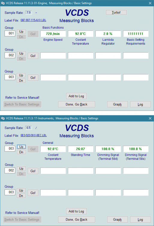

bsdnikolov Posted January 13, 2016 Report Share Posted January 13, 2016 Link to comment Share on other sites More sharing options...
